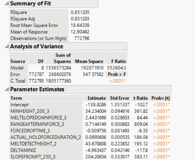

Hi all,
Currently, I try to use Fit Model to create model, so that I could predict output from input variables as well as to make decision whether prediction is outlier or not. However, I am struggling that after I get the model, the model could not clearly point out outliers, highlighted in red
Even I tried to pre process data source such as excluding outliers from data source and then trained model, outliers not really be screened out
Is there any way that I could train the model, so that outlier points could be distinguished
Thanks

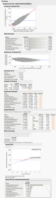

  • Concerning model fitting, I would recommend comparing the models' metrics and analyze residuals. In your last screenshot, you can see that models are very similar, except for the addition of a quadratic effect in model 2. This quadratic effect addition has only slight benefice when looking at R²/R² adjusted and RMSE. It also enforces a non-random curvature pattern in the residuals, so I would really be cautious about the models evaluation and comparison. Maybe using validation points or splitting your dataset into training and validation set could help differentiate the most appropriate model for your data.
  • Concerning outliers detection, as already written in my first response, there are a lot of options available. If you already know these points are strange or anormal, why not labelling them as such and try to understand which factors (and range values) may cause these points ? You could create a classification model (like logistic regression) where your response would be a 2-classes response ("normal" and "outlier" for example) and your factors would be your input variables (like in the models shown).
    Depending on the results/performances of this classification model (confusion matrix, misclassification rate, ...) you can then investigate which factors cause the situation, and use predicted probabilities formula to predict the probability that a new point could be strange/outlier based on the measured values.

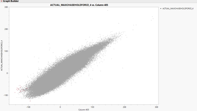

Really appreciate your inputs. For me, my knowledge related to fit model and stats are limited. So just would like to seek some more advices. Let's me clarify what I want. Based on the image below, red data points are bad data points based on our manufacturing criteria. What I want is to separate bad data points far from the fit line. First time, I do Model 1, but seeing that bad data points are not really far from the fit line. Second time, I try to use same inputs from Model1, but this time I do polynomial 2 degree to one parameter, then I see that bad data point is far from the fit line compared to model 1
1. By comparison, summary of fit tables between Model 1 and Model 2 are comparable, but the model 2 is seem what I am looking for. Question - Is there method that I could separate bad data points in reality far from the fit line
2. For the model 1, I am not really understand why bad data points are quite near the fit line. Is there any method to separate it out
I am looking forward to your answers

I believe Victor_G's 2nd point is exactly correct.  The points you have identified as "bad" are not really outliers in the traditional use of the term - they are not that far from the regression line.  The real problem is that you know (from subject matter knowledge) that there is something bad about those data points.  So, what you want is a model to predict those, and the regression model you provided does not do that.  I wouldn't search for different regression models - I think you really want a classification model to predict the points that you know to be problematic.  That is a different sort of model and most of the same methods can be used in JMP, but with a nominal response variable rather than the continuous response variable you have used.
