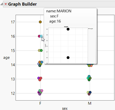

When hovering over a data point, I want the hover graphlet  to be restricted to the data corresponding exactly to the single data point.
my problem: the data point is not fully described by the columns used for x and y axis. In the example.
[I use sex and age on the axes leading to several data points for each sex and age.]
Hovering over one of the data points just restricts the hover graphlet by sex and age, but not to the single data point (which I could get via name  etc).
So, how to get a more precise specification of the data point beyond the x/y axis - without affecting the main graph?
I tried to use Color or Size, but those settings are just ignored by the Hover Label Framework.
Is there a way to tell the Hover Label Framework to pipe an additional column filter to the Hover Label - without changing the main graph?
2 points instead of a single point [corresponding to the entries in the hover label Gridlet: Marion, F, 16]:
dt << Graph Builder( Variables( X( :sex ), Y( :age ), Color( :name ) ), Elements( Points( X, Y, Legend( 19 ) ) ), SendToReport( Dispatch( {}, "Graph Builder", FrameBox, {Set Graphlet( Picture( Graph Builder( Variables( Y( :height ) ), Elements( Points( Y, Legend( 6 ) ) ) ) ) )} ) ) )
