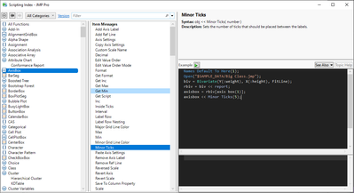

Also I would most of the time suggest sending separate messages instead of using SendToReport. One example could be sending messages to modify axisboxes
