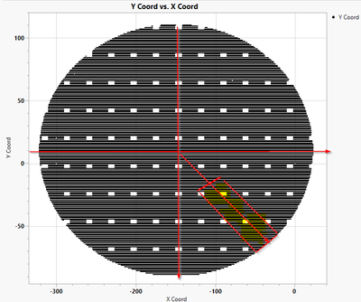

Hi,
Is there a way to select the region on the wafer map like a wedge shape (yellow region in the snippet) across the 4th quadrant of the circle between 4'o clock to 5'o clock?
I am aware of doing lasso selection but I am wondering if I can do a more symmetric selection using formula or jsl way?

Re: Highlight on wafer map
@jthi  I am thinking to create a wedge shape with size X = 8 dies and Y = 16 dies between 4'o clock to 5'o clock with 45 deg angle
Either one is fine. I have roughly highlighted the region. Die size doesn't matter as long as the shape is a rectangle

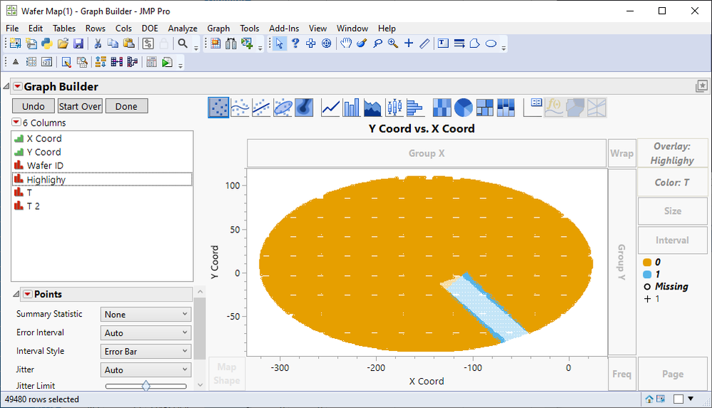

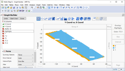

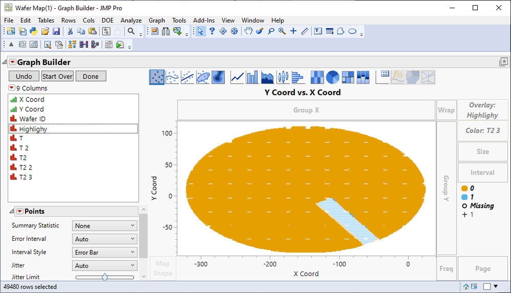

I went a bit wrong way with the rectangle (your shape isn't rectangle) so this doesn't overlay that well with it (I also guessed the corner points).
So I found other function and modified that for JMP. It is closer but it is still using hard-coded corner points
-Jarmo

@jthi  This looks good Jarmo. Can you share the table with formula?
