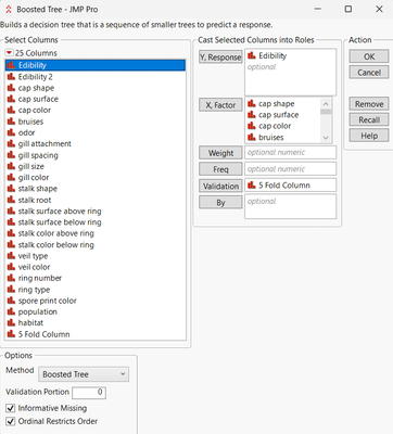

  3. When launching the Boosted Tree (or any other modeling platform, specify your inputs, the response to model, and use the K-folds validation column in the validation panel (here on the Mushroom JMP dataset):

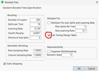

  4. A new window pops up, you have to check "Use Tuning table" and then select your tuning table already open :

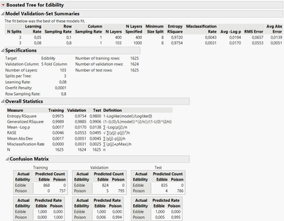

  5. You'll then have the results provided by the best tuned models :

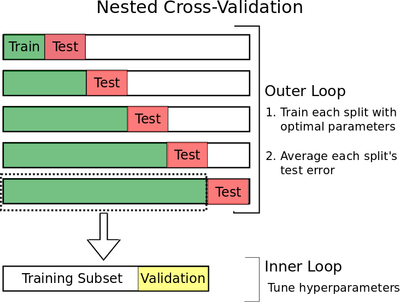

So if you specify a 5-folds crossvalidation in step 1, only the first 3 folds will be used as training, validation and test sets, not really as a 5-folds crossvalidation technique. To do a crossvalidation like you intend to do, you would need a nested crossvalidation : an inner crossvalidation to tune hyperpararameters, and an outer crossvalidation to assess robustness of the hyperparameters values found, only available in Model Screening platform and not accepting Tuning tables for hyperparameters tuning (as the goal of this platform is to screen the most promising algorithms among a large variety of model types, not finetune them) :

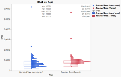

But you can still use K-folds crossvalidation on "default" Boosted Tree, or try using other validation techniques, following the method above (but creating a normal formula validation column with 3 sets) and using simulation on the tuned model to assess its robustness and benefit vs. a non-tuned one :
You can see that in most cases, the default hyperparameters values work quite well, and the hyperparameters tuning help more on the performances variability (performances values like RASE, R-square, ... have narrower ranges on the tuned algorithm compared to the "default" one) than on the max or average algorithm performances.

Nested cross-validation is typically not the first option I would recommend, as it requires a lot of computation, to fine-tune the algorithm independantly on each of the folds of the inner loop, and then calculate the performances on each validation fold of the outer loop.
K-folds crossvalidation is a useful technique in the absence of large quantity of data, but the nested cross-validation still requires a quite large amount to correctly do the data splitting: for example, if you split the inner loop in 4 folds and the outer loop in 5 folds, it requires to create 20 folds/groups in your dataset !
