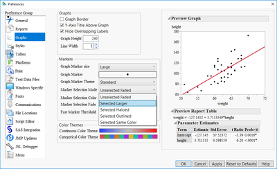

ron_horne
Super User (Alumni)
Re: Highlight certain points in bivariate plot
Hey gandi2223​,
MS​ is right and gave you a robust solution.
if you need a softer approach for a one time fix try selecting the observations you want to sand out after fixing the following in the File>> Preferences
