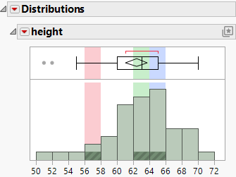

Mock-up of what I would like to achieve:

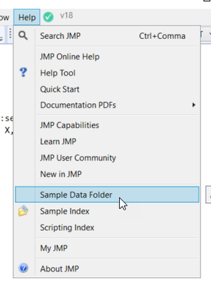

Could you pick a suitable file from the samples folder and create a mockup which illustrates the issue?

You can do this maybe with reference lines
Names Default To Here(1);
dist = dt << Distribution(
	Stack(1),
	Continuous Distribution(
		Column(:height),
		Horizontal Layout(1),
		Vertical(0),
		Set Bin Width(2),
		Process Capability(0)
ab = Report(dist)[AxisBox(1)];
ab << Add Ref Line({60, 62}, "Solid", "Red", "", 1, 0.25);
ab << Add Ref Line({62, 64}, "Solid", "Green", "", 1, 0.25);
ab << Add Ref Line({64, 66}, "Solid", "Blue", "", 1, 0.25);

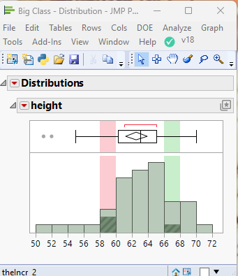

Here is my take on how to do this.  It finds the selected rows and the bins associated with them, and then adds the reference lines as required.
Names Default To Here( 1 );
// For illustration, randomly select some rows
For( i = 1, i <= 3, i++,
	dt << select rows( Random Integer( 1, N Rows( dt ) ) )
	Stack( 1 ),
		Column( :height ),
		Quantiles( 0 ),
		Summary Statistics( 0 ),
		Horizontal Layout( 1 ),
		Vertical( 0 ),
		Set Bin Width( 2 ),
		Process Capability( 0 )
distRPT = Report( dist )[AxisBox( 1 )];
// Find the Midpoints of the bins the selected rows are in
dist << Save( "Level Midpoints" );
theBins = (Associative Array( Column( dt, N Cols( dt ) )[dt << get selected rows] )) << get keys;
dt << delete columns( N Cols( dt ) );
// Get the Increment of the X axis
theIncr = distRPT[AxisBox( 1 )] << get inc;
// Add the reference lines for each selected bin
For Each( {bin, index}, theBins,
	binList = {};
	Insert Into( binList, bin - theIncr / 2 );
	Insert Into( binList, bin + theIncr / 2 );
	Eval( Eval Expr( distRPT << Add Ref Line( Expr( binList ), "Solid", Expr( Index + 2 ), "", 1, 0.25 ) ) );

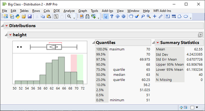

I was able to use the add Ref as you and @jthi suggested. I used the approach for coloration and confirmed it will work for a single distribution. When I add By conditions, I lose the plot addressing capability resulting in errors.
As suggested by @hogi I switched to available data for this question. To help facilitate the question I augmented Big Class in a modified version of Jim's script. Here are the steps I followed and the outcomes
1. Import Big Class
2. Conditionally add some data if the column "State" is not in the table
    a. Add a column named State with sequenced data to place people in either "CA", "WA" or "OR".
    b. Add a second "PATTY"  who is 16, "F", 57, 134 and is in "WA".
3. Select some names. I chose LESLIE and PATTY
4. Run script to find and highlight bins of interest.
OK Case - remove By (:State) from the script below and change the preceding comma to a semicolon to run successfully. The code finds both instances of Patty and uses different colors for each of them. If they had the same height, for this example the reference lines would overlap only showing one of the two colors.
@hogi made a good point about the arbitration of which color is shown. Once I understand the element addressing, I plan to add a conditional for the case where more than one interesting data point occurs in the same bin.
NG Case - run distribution with a By condition based on :State and see an error in addressing the plot object. I tried  a few addressing permutations without success. I am missing key information to access the AxisBox.
Did not work either:
distRPT = Report( dist )["height",AxisBox( 1 )];
distRPT = Report( dist )["State=WA","height",AxisBox( 1 )];
distRPT = Report( dist["State=WA"] )["height",AxisBox( 1 )];
Sample error code: object not subscriptable at row 41 in access or evaluation of 'Report(dist)[ /*###*/AxisBox(1)]' , Report( dist )[/*###*/AxisBox( 1 )]
	binList = {};

hogi
Level XIII
Re: Highlight bins in a distribution based on a column value to highlight bin migration
If you need the BY groups, it gets a bit more complicated.
Every subplot can have different bin widths. This is why a for loop is necessary:
- to get the individual bin widths.
- to get the selected rows for the specific subplot
- to add the ref lines to the specific subplot.
Hm, maybe rethinking the idea of the shaded regions - we also have the issue with the colors.
At the moment, we just apply a different color to every selected bin. The shaded regions look nice - but the width is quite arbitrary. Maybe just add a line per selected ID? How many "IDs" do you want to select?
When it smells like tape, it's time to ask: are we reinventing the wheel?

hogi
Level XIII
via Graph Builder:
