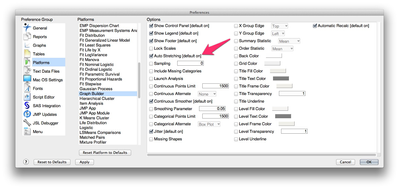

As for the sizing of trellised graphs, you can toggle that with the Auto Stretching option that you can see by holding down the shift key when you click on the red triangle menu.
You can also turn this off by default using the Graph Builder Platform Preferences.

Thanks Jeff - that solved the stretching issue for me.

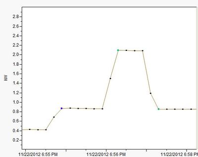

I've created a line chart in Graph Builder, with points marked along it.  I want to highlight the points that represent a major change in the y-axis value (see the colored points below)

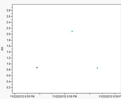

In JMP9, I could select all of the black points and "hide" them, leaving the line and just the colored points.  In JMP10, I get this when I hide the black points:
The line disappears!  This is also the case in the overlay plot where the line will only connect visible values.  In effect, Hide seems to be doing the same thing as Exclude, and previously they were different.

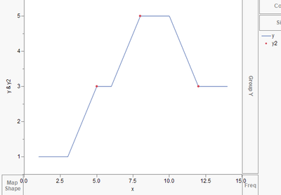

A clumsy work-around is: create a duplicate of your Y column with only the 3 interesting values, add both Ys to GB, but turn one off for the Line element and turn the other off for the Points element.

Thanks Xan.  I tried out the duplicate column, but the only way I could see to make one of the Y-axis values line and the other point is to move one of the Y's to the right side.  It gives the basic visualization I'm after, but it means that the two scales are dissociated and will be different when I try to zoom in or resize.

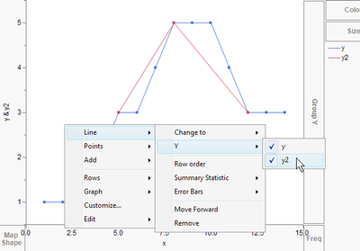

I just fixed a typo in my response that made it hard to understand ("on off" -> "one off"). Here's a pic of the confusing part, using the Y submenu to turn off a particular Y for a particular element.
The result after doing both elements:

That works great.  Thanks for the images, because I didn't realize I had independent control of Ys through the sub-menu.  I revised my scripts to create the new column and generate the modified graphs.
