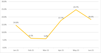

Example 1 - This graph is from Excel and is what I would like to be able to produce in JMP

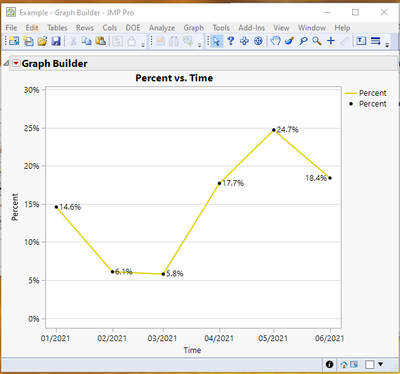

Example 2 - My best attempt in JMP at getting a line graph labeled

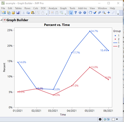

Here is my JMP version of your graph
Attached is the data table with the embedded graph
Jim

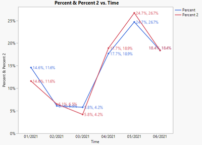

Hi Jim! Thank you for the response! A secondary question related to that method, if I have two lines on the same graph, the data points double label both lines. I could be applying the labels incorrectly, but is there a way to have them on the same graph and labeled separately?
Thank you!
