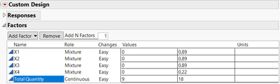

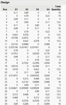

I also thought about using Mixture design, but since the total quantity of X1+X2+X3+X4 is not fixed (it should be between 9 and 18 units), I switched to an Optimal factorial design.
The Mixture design can be a good alternative for this use case by adding a 5th continuous factor for the total quantity of component that can vary between 9 and 18 :
Specifying a Scheffé Cubic model and adding a quadratic effect for X5 (Total Quantity) enables to have an interesting design respecting all the constraints :
(Value of X4 for row25 could be switched to 0 without big changes, to avoid using 4 components in the mixture if really needed).
Script to generate the design :
