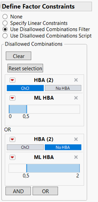

I would recommend setting the factor ML HBA as a discrete numeric with three levels instead of a 3-levels categorical factor, as the ordering between levels is taken into consideration with the discrete numeric factor type, and it does suit better your experimental design from what I see. It also facilitates the creation of the disallowed combinations constraint.
If I set up the disallowed combinations like these :
Or in a script version :
HBA == "ChCl" & ML HBA <= 0.5 | HBA == "No HBA" & ML HBA >= 0.5

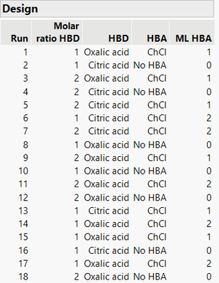

Then the generated design seems to respect the constraint you want:
Here is the script to generate the design (I assumed a model with main effects and 2-factors interactions) :

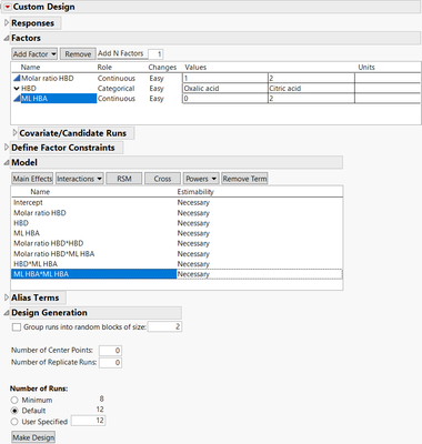

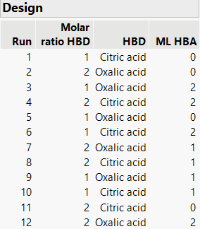

Looking at the new post Design of Experiment - Optional Mixture Additives, I wonder if your situation is not similar (since factors HBA and ML HBA are related ?) and the required design may not be more simple than what I suggested ?
Would it make sense for your experimental setup to consider creating a design with 3 factors :
  • Molar ratio HBD : continuous factor, range 1-2
  • HBD : 2-levels categorical factor, oxalic acid or citric acid
  • ML HBA : continuous factor, range 0-2
This setup enables to avoid nested factors, simplify the analysis and covers a broader and continuous experimental space. The situation with "No HBA" would be represented when ML HBA has the value 0.
To have three levels for the factors ML HBA, you can enter the quadratic effect of this factor in the Model panel :
The design obtained with the default number of runs look like this :
Here is the script to generate the design :

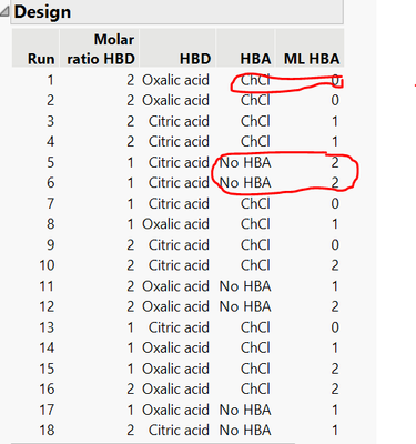

So here I applied the constrain, but I still combination where molar ratio (ML HBA) is 0 and HBA is ChCl.
What I want is that if HBA = ChCl then ML HBA should be >0, or if HBA = No ChCl then ML HBA = 0. Does that make sense? I attached my DoE table (I hope)

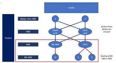

The factors "HBA" and "ML HBA" are not independent, since the levels of "ML HBA" depend on the choice of the level for "HBA". This situation reduce the effective detection of these effects, as they are not independant (you can see in your power analysis). There might be no solution to this, increasing the sample size might help but won't solve entirely the problem.
For example, if HBA is set to "No HBA", then the only possible value for "ML HBA" is 0. This dependance creates a nesting effect : "ML HBA" is nested within factor "HBA". Or if you want to see this situation and your experimental design more easily and graphically :

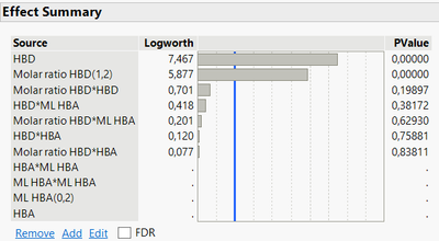

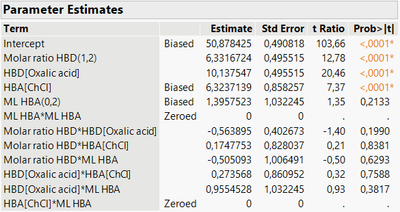

Let's see how this situation might impact your regression model through a simulated example. I created a response formula Y with the following equation :
If we simply click on script "Model" with the assumed model from the generated design (or use script "Fit Least Squares (normal)"), with all main effects and 2-factors interactions estimated independently, we encounter some errors due to the non-independance between ML HBA and HBA:
  • There is a "Singularity details" panel added, showing linear dependancies among our predictors :
  • Looking at the "Effects Summary" panel, not all effects can be estimated (even if we generated a design able to fit these terms/effects):
  • Looking at the "Parameter Estimates" panel, we see that main effects HBA and ML HBA are noted as biased (and estimated with a relatively large standard error), which again is an indication that they couldn't be estimated independantly :
All these informations show indication that our regression model may not be appropriate in the context of nested factors. In order to solve this problem, you can manually specify the effects contained in your regression model through the Fit Model platform to include a nesting effect of ML HBA within HBA :

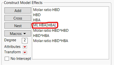

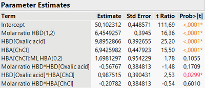

To create nesting between factors, you can check this section of JMP Help : Example of a Two-Factor Nested Random Effects Model (jmp.com)
Since not all factors are crossed, it's only possible to estimate 2-factors interactions for factors that are not nested. In this case, you could add interactions between "HBD" and "Molar ratio HBD", "HBD" and "HBA", and "Molar ratio HBD" and "HBA".
Running this model (use script "Fit Least Squares (nested)"), you can see there is no singularity anymore, all effects can be estimated, an no terms coefficients are biased. You can also see that coefficients for the terms are close to the one specified in the formula seen before, so the full model seems to be quite appropriate :
Of course, depending on your performance metric (RMSE, R² and R² adjusted, statistical significance, information criterion like AICc and BIC, ...), you could further refine the model. But you should start first with your complete model assumed from your experimental design.
I join the datatable with all scripts and formula used for this example.
