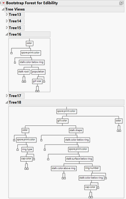

I tried to play with two sample datasets, Diamonds Data.jmp (regression task) and Mushroom.jmp (classification task).
I got the same impression as you with the regression task, even when playing with hyperparameters, the individual trees were quite complex. However, I got more simple and satisfying individual trees with the classification task, with diverse depths and complexities :
So again it won't directly answer your question about a possible change in bootstrap forest algorithm between JMP versions (this may be something best answered by technical staff at JMP, @Mark_Bailey ?), but I think the complexity of individual trees are linked to the precision needed for the task (regression equivalent to very large number of classes vs. classification) and the data available (quantity and quality).
Hope this answer may still help you,
Victor GUILLER
