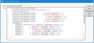

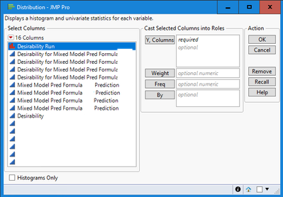

  When I run the parent script, the two new table scripts are added (again the GB script works just fine), but when I try to run the Distribution script from the data table (green triangle), instead of showing the results, it opens up the Distribution platform window.
NOTE: names have been removed to protect the innocent ;-).

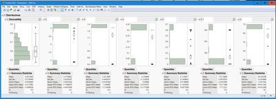

  First off, it shouldn't do this, it should actually bring up all the distributions as laid out in the new script (when I run the script stepwise in the parent JSL, it works).
  Here's the very strange part. If I open up the new script in the data table (Edit Script), and click Run, it works exactly as intended.
  I can't figure out what I'm doing wrong -- the JSL works, but for whatever reason, when I try to run it from the green triangle, it doesn't work, which doesn't make sense to me. Have I missed something or have a wrong call/command somewhere? Have others come across this strange behavior, and if so, how did you get around it?

  Actually, the problem was a bit of a mix of both. For one, the Column() call should not have been in the Expr() call. Two, the proper reference to the column for the Distribution platform needed to be used, but because I'm saving this as a data table script within the parent JSL, I can't just refence the column as :"name"n, I have to build that within and Eval Insert(), and also Parse() it within and Expr() call.
  What ended up working for the Distribution platform was the following:
	Eval(
		Eval Expr(
			Distribution(
				Continuous Distribution( Column( Expr( Parse( Eval Insert( ":\!"^ListNames[Nitems(YCols)+1]^\!"" || "n" ) ) ) ) ),
				Process Capability( 0 )
  This built the proper column name reference for the Distribution platform and allowed for an executable script that could be saved to the data table. A bit cumbersome in my opinion, but it works, and that's what matters.
