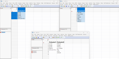

I have two tables, let call them dt1 and dt2
Each table has one column each Column1 in dt1 and column2 in dt2.
I need to (either update or create a new table ) that has contents of Column1 mapped to to contents of Column2 by manual selection. Since the column entities are so different a join or update feature cannot be used.
My aim is to create a user interface that allows the user to select row by row matching of content in the two columns.
Unfortunately no. This assume that a list exists that maps one column to another. I am practically trying to create such a list.
So for this question purpose let assume that I have only two tables dt1 and dt2 and each of them has only one column, column1 and column2 respectively and I want to map some contents of column 1 to contents of column2. ( I use "some contents" because the number of rows in the two columns is different)

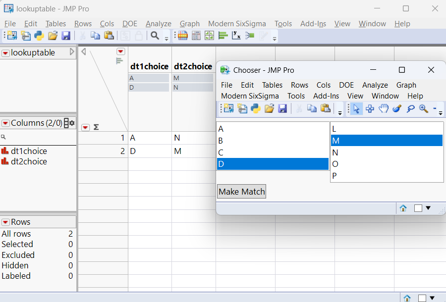

Hi Jed_Campbell, This should in principle work but I get the following error when trying to run this code on already opened tables dt1 with Column Choice1 and dt2 with Column Choice2. I am using JMP17.
Scoped data table access requires a data table column or variable in access or evaluation of 'dt1:Choice1' , dt1:Choice1/*###*/
Hi Jarmo, Thank you so much. It is very helpful. In your code you compare first columns of each table. Can we modify it where specific column of one table at random location can be compared to a specific column ( irrespective of column number) in the second table?
It can easily be modified in such a way. Would the user pick column from the first table and then it is assumed same column exist in second table? Or should user be able to pick columns from both tables?
