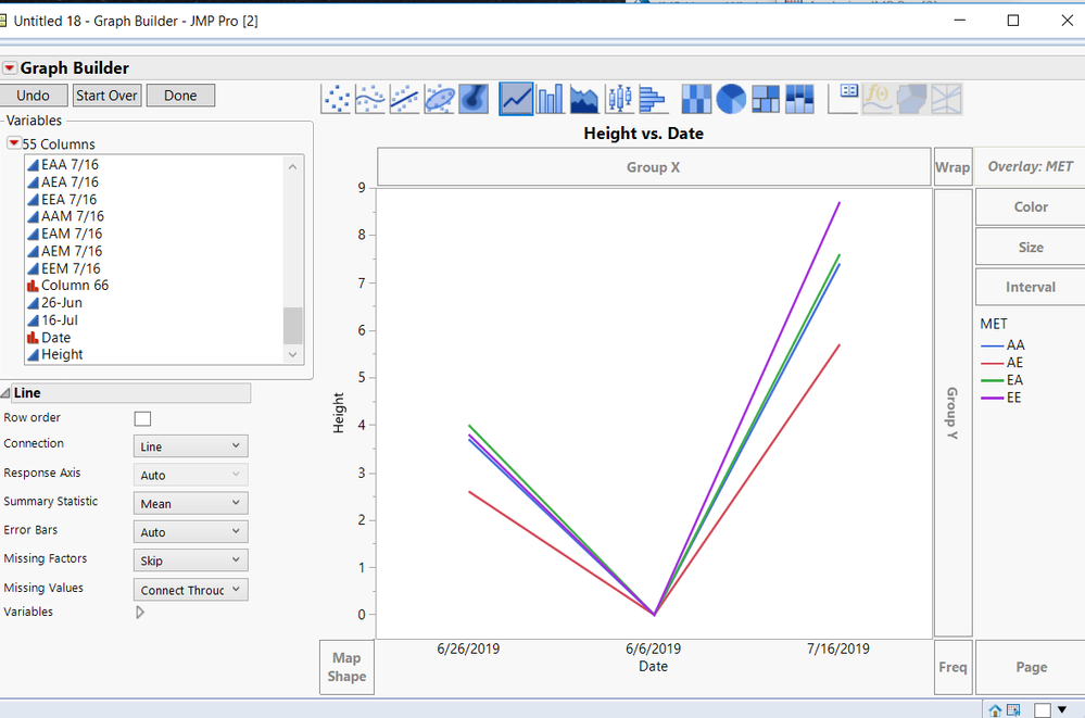

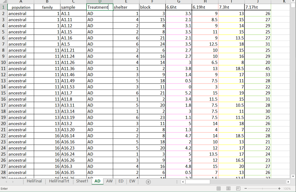

I'm new to jump and am having trouble making a growth by date chart.
I have tried using graph builder and overlay plot but have not had any luck so far. I have a bunch of height data for plants in different treatments and I want to make a line graph with date on the x-axis and the mean height at each date on the y-axis with separate lines for each treatment.
I cannot figure out how to separate by date correctly so my graph keeps separating the mean height at each date into the separate lines. Can anyone help me figure this out? Thanks in advance!
I included a picture of the data I am trying to plot and the graph I keep getting in case they help.

The issue is that you have both dimensions you want on the graph, coupled together in the columns.  i.e. column 6.6ht header is the date, which is your desired X dimension, and the data in that column is what you want displayed for the Y axis.  I think you can easily get what you want by stacking your data
     Tables==>Stack
So if you stack the 4 data columns you will end up with a column with the headers(dates) and a column with the data.  You can then easily plot the data.
