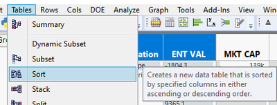

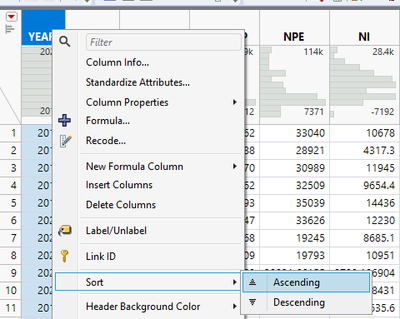

You can sort your data using right click
or using Tables > Sort

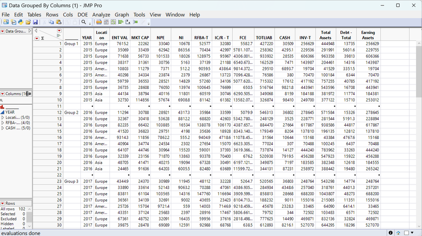

If I am understanding you correctly, is what you want is for displaying of your data table, you want to change it into a JMP data table that looks like:
Is this correct?
Do you want to do this interactively or do you want to have a JMP script modify your table to a form like this?
