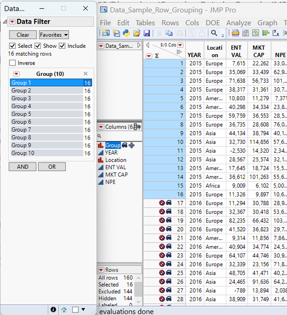

Re: Grouping Data by Rows in JMP Pro 18
The column panel on the left side of the data table only groups columns, not rows.  However, one can use a Data Filter to allow for the grouping of rows.  In my example I created a column called Group which had a value for each row....Group 1 for 2015, etc. I subsequently hid the column.  The data filter was then created, selecting upon column Group
Hi Jim, I think your idea might just do the trick! I’ll test out the data filter you mentioned. Appreciate it!
