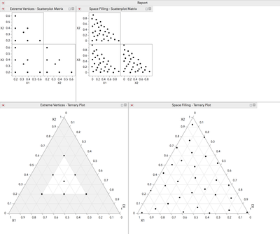

I am looking to discover how to get a Graphical Picture of the Design Space for an Extreme Vertices Design and a Space Filling Design. I know how to generate the Design but would like a picture showing the Design Space and all of the Design Points.
The ternary plot Lou mentioned is found under Graph > Ternary Plot in JMP. To generate a ternary plot from a mixture DOE you would just add the factors you want to plot to the "X, Plotting" part of the dialog and hit "OK."
