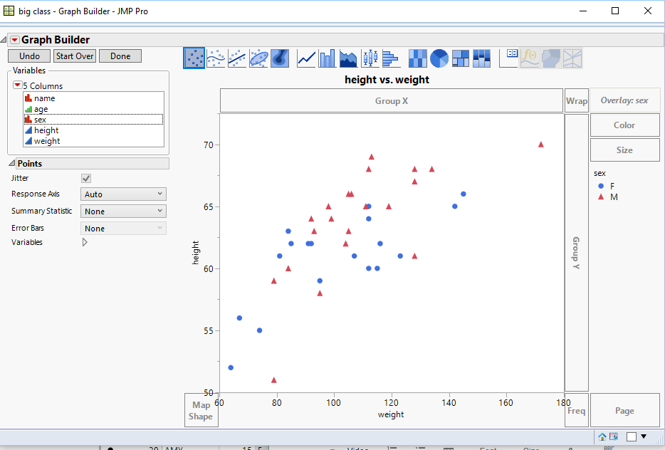

Hi ~ Is there a way to change the graphic default markers so that a different marker symbol is shown for each overlay series? Currently, I can get only a single marker style that changes color with the series.

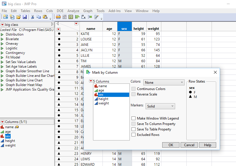

You can do this by going to the data table and use 'Color or Mark by Column" and set the marker for the column that you are going to overlay by.  Then when you set the overlay in Graph Builder, different markers will be used for each different value.
