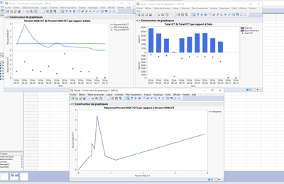

Hello everyone,
I’m having an issue with my graph display. I selected the line option, but the first column appears as a line while the second shows points, and there’s also an enumeration appearing. Please see the attached image for clarification.

You need to have a separate Elements paragraph for each of the Y variables specified.  Below is an example of the method your code uses which replicates your results, followed by an example using the correct syntax to get what you want.

I have a question please. Can you help me figure out how to change the bar color ?
In the screen, each parameter shows a color, but the graph displays 2 bars in blue, and the 2 last one being red.
txnelson
Re: Graph display issue
Right click on the bar color in the legend, and select "Fill Color", then click on the color you want.
