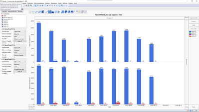

Hello everyone,
I’m having an issue with my graph display. I selected the line option, but the first column appears as a line while the second shows points, and there’s also an enumeration appearing. Please see the attached image for clarification.

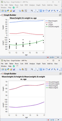

You need to have a separate Elements paragraph for each of the Y variables specified.  Below is an example of the method your code uses which replicates your results, followed by an example using the correct syntax to get what you want.
Names Default To Here( 1 );
dt =
// Open Data Table: Big Class.jmp
// → Data Table( "Big Class" )
Open( "$SAMPLE_DATA/Big Class.jmp" );
Graph Builder(
	Variables( X( :age ), Y( :height ), Y( :weight ) ),
	Elements(
		Line( X, Y(1) ),
		Line( X, Y(2) )
Graph Builder(
	Elements(
		Position( 1, 1 ),
		Line( X, Y, Legend( 11 ) )
	Elements(
		Position( 1, 2 ),
		Line( X, Y, Legend( 12 ) )
Jim

I have a question please. Can you help me figure out how to change the bar color ?
In the screen, each parameter shows a color, but the graph displays 2 bars in blue, and the 2 last one being red.
txnelson
Re: Graph display issue
Right click on the bar color in the legend, and select "Fill Color", then click on the color you want.
