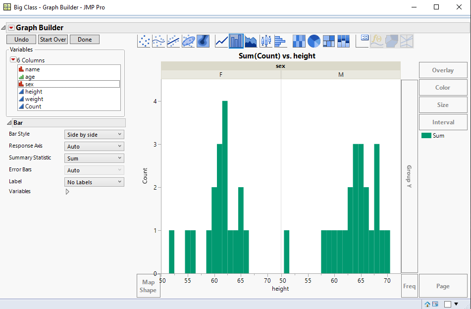

I genrated a histogram using the graph builder as shown in the attached plot. I want to add the count of the Y axis. Please show me how to add.

The way that I do that, is to create a new column in the data table, and call it "Count", setting each rows value to 1.  I then go to Graph Builder and select my x axis and then set my y axis to the count column, and it's statistic to sum.
There are soooooo many things you can do with Graph Builder, that there may be a Community member that can show a better way to solve your problem

Thanks @txnelson. This solve my requuirement.
is there a way to add the N value in the histogram from the Graph builder?
Appreviate your help.

Sure, just specify "Label by Vlaue" for the labeling for the Bar specificationshisto2.PNG
