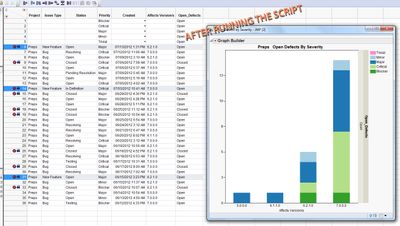

Ok --- here is what I have and it works fine.... --- thanks to the suggestion of Xan....
I added 5 'vacant' rows of data ----  the only field that is entered on each row is in the column marked 'Priority' ----  The script creates 5 rows at the beginning of the data table and populates the Priority column with 5 entries
dt<<Add Rows(5,0);
:Priority<<values({Blocker,Critical,Major,Minor,Trivial});
The remainder of the script filters out those rows because no other fields within the rows have data - so these new rows do not corrupt the graphs that are generated (i.e. showing the additional Priority data).
Now every graph generated shows each of the 5 priorities in the Legend even if those priorities did not exist in the original data -----  this helps with consistency in the color scheme we developed for each priority and in the order they are presented in the Legend. ---- we populate a PowerPoint with side-by-side graphs so it's important the color scheme and order within the Legend are consistent....

Re: Graph/Legend flexibility
Kun,
Attached you should find the JMP script (Adding rows Script.jsl), the dataTable (general_report.jmp) and a screen shot of the results (After.jpg)....
The script adds 5 new rows to the top of the dataTable, then it populates those 5 rows with 5 unique character names in the 'Priority' column.   This will make sure that every graph generated using this script will show all five names in the Legend.    I do this because as new dataTables are generated over time some will have all 5 names and some will not.   When they don't have all 5 names the Legend does not remain in the same order or color scheme ---- so when comparing graphs from previous runs the Legends don't match and it it is confusing.    By forcing the 5 names it produces Legends that are consistent....

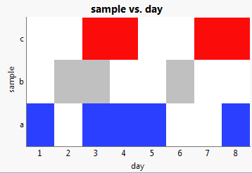

XanGregg
Staff
Kun,
Stacked bars might work if you add a filler white category for the gaps. Another idea is the Heat Map element in Graph Builder. Pic attached. Are you can make a scatter plot and choose a filled rectangular marker for each point.2294_heatmap.png
