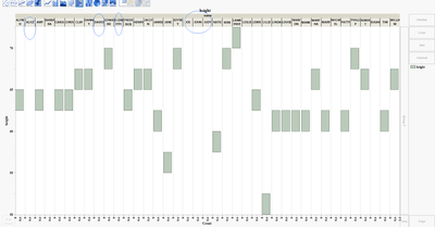

Hi,
I'm using JSL to produce graph builder plots. These plots are plotted against one or multiple variables. The problem is that sometimes, graph builder produces empty plot with no value. Is there are a method to remove those empty sub-graphs? For a better understanding of the problem, I have attached an example. In the example, ALICE, DAVID, ..etc. have empty plots. Those are the one I'm trying to remove using JSL script.
I'm thinking of using the Empty() OR Is Missing() function to check if a specific cell is empty, don't plot it.
My question is that is there are a way to select that specific cell and remove it from the plot ?

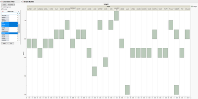

I would do it using a local data filter.  You can script this specific example as follows:
Names Default To Here( 1 );
dt = Data Table( "Big Class" );
thenames = dt:name[(dt << Get Rows Where( Is Missing( :height ) ))];
Graph Builder(
	Size( 857, 534 ),
	Show Control Panel( 0 ),
	Variables( Y( :height ), Group X( :name ) ),
	Elements( Histogram( Y, Legend( 4 ) ) ),
	Local Data Filter(
		Inverse( 1 ),
		Add Filter(
			columns( :name ),
			Where( :name == thenames ),
			Display( :name, N Items( 15 ), Find( Set Text( "" ) ) )
It's also easy to do with the menus in Graph Builder.

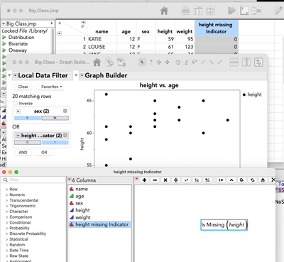

In this case I have missing height data, and a column with an indicator for missing height.
In the filter I can do this :  Where((sex = F) or (height missing Indicator = 1))

Hi @Byron_JMP sorry, the solution doesn't seem to fit to:
show me all data points which fulfill:
1)  non-missing data -> inverse of (missing height values)
AND
2) sex = "M"
maybe with an "inverse" around it ...
one could generate a suitable data filter for this special case - and every user with a PhD in set operation logic will love it.

the key to making solution work is adding a column with the formula:  is missing(:column name)
this returns a 0 or a 1 in the formula column. 0 = not missing.
Indicator columns are your friend.
