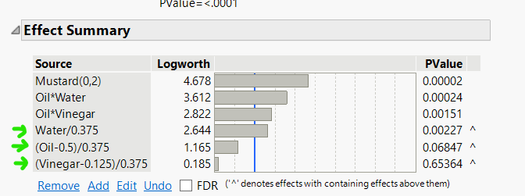

When this is activated, my main effects have strange forms like in the picture below:
I prefer when they have a cleaner view, just Oil, water and vinegar (not in the form of ratio). Apart from the visual aesthetics preferences, there is something that confuses me even more. When I export ththe equation for this case and I simplify it, it looks like:
The number in the green circle seems to me like an intercept and in mixture doe, the model normally does not have intercept.

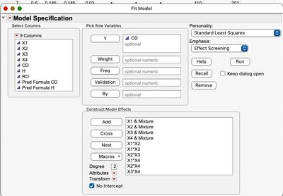

Regarding your model, did you check the "No Intercept" box when you ran the fit model?

Thank you  @statman  for your answer,
Yes I had that option checked.

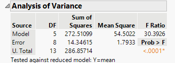

Now for the second part about the mysterious intercept. You should NOT have an intercept if you have turned off the pseudocomponent coding. I am guessing that you are not really fitting a mixture model. To verify this, in your model output go to the red triangle and go to Regression Reports > Analysis of Variance. Look at the Analysis of Variance table. At the bottom of that table you should have a message of "Tested against reduced model: Y=mean" like this:
This indicates that you are fitting a Scheffe model. If it says "Tested against reduced model: Y=0" then you are NOT fitting the Scheffe model. More than likely there are some row(s) in your table where the mixture components do not add up exactly to 1.
