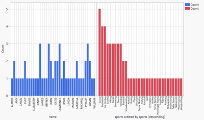

Hm, there is still this bug with multiple response and multiple histograms in Graph Builder.
Maybe illustrative:
Names Default to Here(1);
dt = Open( "$SAMPLE_DATA/Big Class Families.jmp" );
Graph Builder(
	Variables( X( :name ), X( :sports, Order By( :sports, Descending, Order Statistic( "N" ) ) ) ),
	Elements( Position( 1, 1 ), Bar( X, Legend( 3 ), Summary Statistic( "N" ) ) ),
	Elements( Position( 2, 1 ), Bar( X, Legend( 4 ), Summary Statistic( "N" ) ) )
the right plot shows how many students participate in which sports activity - and the left graphs shows the number of students with the same name:
students with the same name ?!?!
It's Robert, right?

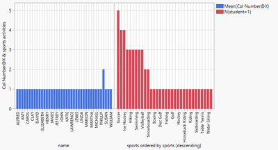

Counting students with the same name is not possible via the Summary Statistics (N) in Graph Builder - due to the multiple response column on the right, there are too many "rows". This happens as soon as a multiple response column is used within the same report,  on an axis, as color, size, ....
A workaround: do the counting "manually" - via a transform column:
Graph Builder(
	Transform Column( "student=1", Formula( 1 ) ),
	Transform Column(
		"Col Number@X",
		Formula( Col Number( 1, :"@Exclude"n, :"@Filter"n, :"@Graph"n, :"@Overlay"n, :"@X"n ) )
	Size( 573, 393 ),
	Summary Statistic( "Median" ),
	Graph Spacing( 4 ),
	Variables(
		X( :name ),
		X( :sports, Order By( :sports, Descending, Order Statistic( "N" ) ) ),
		Y( :"Col Number@X"n ),
		Y( :"student=1"n, Position( 1 ) )
	Elements( Position( 1, 1 ), Bar( X, Y( 1 ), Legend( 3 ), Summary Statistic( "Mean" ) ) ),
	Elements( Position( 2, 1 ), Bar( X, Y( 2 ), Legend( 4 ), Summary Statistic( "N" ) ) )
now the plot looks much better:
Up to now, it was quite complicated to generate a graph like this - one that is "interactive" like a standard Graph Builder plot:
what happens when the user drags another column onto wrap - or onto an X axis?
The new scoping option in JMP19 make Transform Columns - as comfortable as Summary Statistics (💚)
A new era of Graph Builder!
see: New in Graph Builder for JMP 19 by @XanGregg
you want to count the students by age - just drag age onto the x axis  and the counting will adjust automatically to the new categories:
