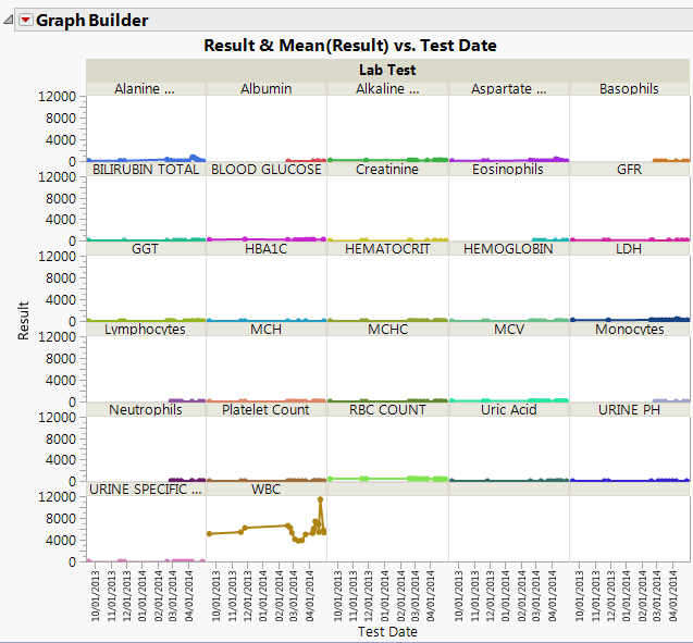

Is there a way to use the wrap functionality of graph builder where all graphs share a common x axis (time), but have differing Y axis scales?  I tried the Page option which is OK, but I'd prefer a grid of graphs.  Here's an example where one of the graphs throws the scale way off for the other graphs.

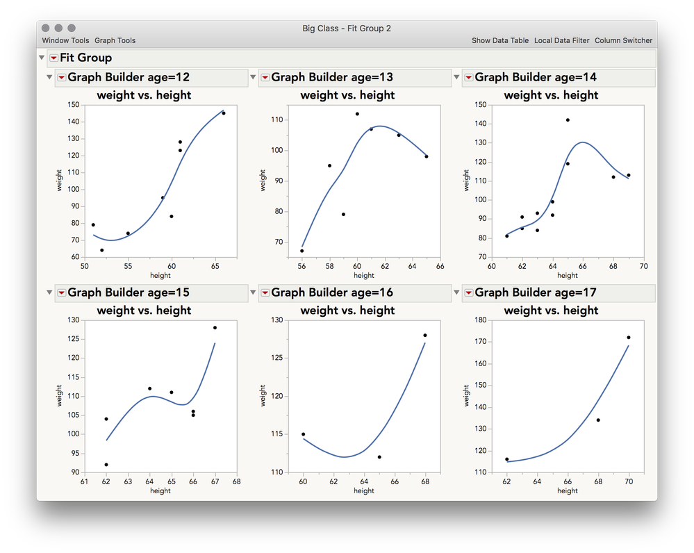

julian
Re: Graph Builder Wrap With different Y Axis Scales
It occurs to me that Peter's original question was about Graph Builder and I gave a solution using Fit Y by X.  If you need Graph Builder functionality, it turns out you can also use Fit Group() with Graph Builder output using a By variable:
Names default to here( 1 );
dt = Open( "$Sample_data/Big Class.jmp" );
Fit Group(
	Graph Builder(
		Size( 300, 300 ),
		Show Control Panel( 0 ),
		Show Legend( 0 ),
		Variables( X( :height ), Y( :weight ) ),
		Elements( Points( X, Y, Legend( 1 ) ), Smoother( X, Y, Legend( 2 ) ) ),
		By( :age )
	<<{Arrange in Rows( 3 )}

julian
Fit Group(
	Graph Builder(
		Size( 300, 300 ),
		Show Legend( 0 ),
		By( :age )
