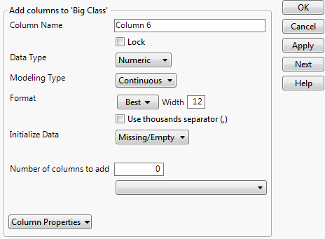

It should be pretty easy to fix by making sure that your Flow Rate column is set to the Continuous modeling type. If you can't change it to Continous it means that the column is also set to the wrong data type. It should be numeric, not character.
Column Info dialogColumn Info dialog
-Jeff
-Jeff
