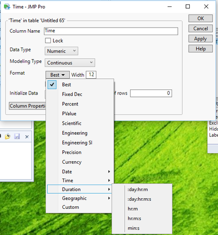

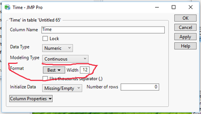

Just set the column format to one of the Duration formats available.  Go to Column Info for the column, and click on the down arrow beside the format and select Duration, and then choose which of the potential formats you want to use
Jim
Re: Time in Seconds to HH:MM:SS Format
Like Jim, I assumed that when you said that you had data in the form of seconds (time), that you entered it as a numeric value. It never occurred to me either that you would enter it as character data.
So following Jim's solution, first change the Data Type to Numeric and the Modeling Type to Continuous. Then continue with his detailed step-by-step instructions.

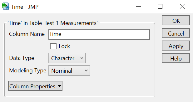

Thanks but I can't seem to find format when in the column info dialogue box?

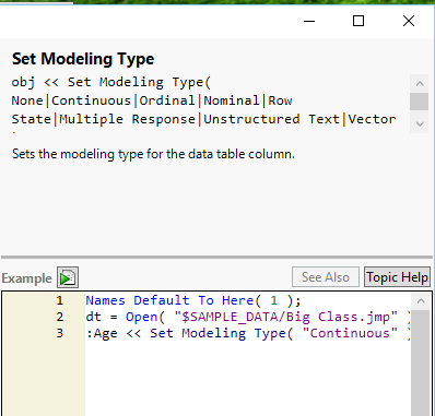

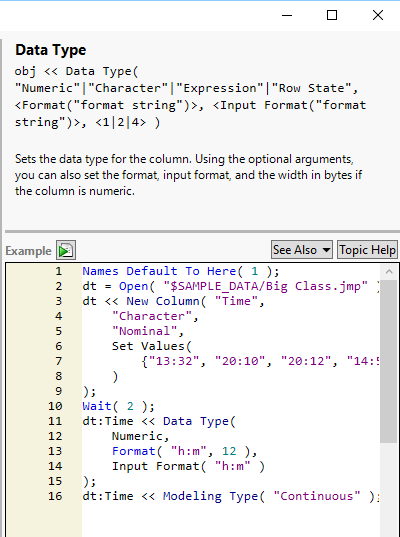

Your code is not working because your syntax is incorrect.  You can find all of the correct syntax and examples in the Scripting Index
     Help==>Scripting Index
In your code, all of the issues are covered in the Data Table==>Column Scripting
