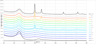

Hello - I have a spreadhseet in Excel that outputs a plot of multiple series all stacked and displaced from eachother, but also allows replicates to have a tighter spacing, as seen below:

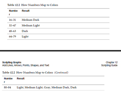

  According to the JMP JSL Scripting Guide v16, pp. 660-662, the standard JMP color schemes are:
  And then each of those colors can be subsequently altered by making them light, medium light, medium dark, and dark:

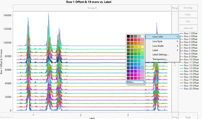

  Or, once you get the graph looking like you want, you can always right click a spectrum of choice and then select Line Color, and choose any preset color shown, or even Other... from a larger color palette. But, this can be slow if you have lots of spectra.

@txnelson In my case, I have about 50 variables that I could use as defining of the series of series. Those two in the picture I shared I think are true replicates, but what I'm looking for wouldn't require two entire rows to be identical to be matched.
I guess if I had to design it, it would maybe have a drop box for a "series" variable, to test whether any series should be matched (and show up closer or not). I suppose this series variable should also have the ability to color the points, or change the size, or something else. And then maybe a slider to adjust the scale factor @hogi mentioned for the gap between the two.
I'm pretty sure what I just described isn't possible currently in JMP, so ... XY problem with that wishlist I just gave, but hopefully that clears up what I'm looking for and maybe there's some GUI way to do it? If not, @hogi's method would work.

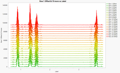

  Here is some JSL code that will do part of the job -- it easily adds a fixed offset to each spectra and it adds the same amount to each additional spectra. So for the first spectrum, there is no offset, but then each additional spectrum, they get an offset of n*5000, I used 5000 in my case -- I used the NMR DoE.jmp sample data table and transposed it to get columns of spectra, which is I'm guessing how your data table is structured rather than rows as spectra and columns as wavelengths. Anyway, you should be able to modify this code to work best for your data structure and data tables. I'm attaching the code and modified sample data table so you can see. Here are the results. You can then go in manually and edit the offset for any replicates or specific spectra that you need to.
  The top graph is without an offset and the bottom graph is with an offset. Color coding is automatic by JMP.
