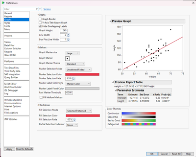

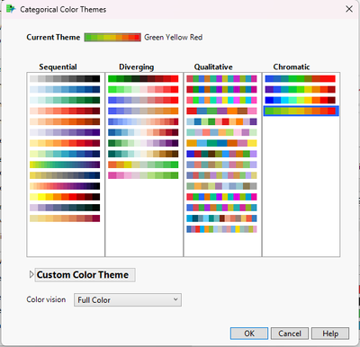

Or, if you wanted to change the global color scheme, you could go under File > Preferences, select Graphs up top (on the left), then click on the color scheme called "Categorical", bottom right hand.
You then get a screen like this, and for example, if I choose the bottom Chromatic style and again plot the spectra, it looks like this (the order can also be reversed):
  The only drawback to that method is that this is now the global color scheme for all graphs within JMP, not just the one you happen to be working on. You can always go back and change it in Preferences if you want.
