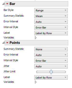

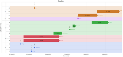

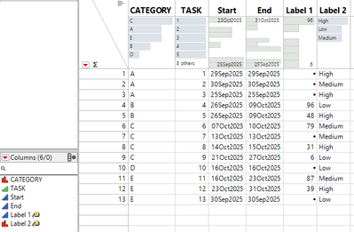

I have a Graph Builder chart that has both bars and points.  I have two columns that I have selected for labeling (see data table screenshot).  In Graph Builder for both Bars and Points, there are options to Label by Row, Label by Value, or Label by Row and Value, which puts the labels in the positions I would like for each.
In this case, I want the Bars to be Labeled by "Label 1" rows only, and the Points to be labeled by "Label 2" rows only.   From what I can tell, I am only able to have the same labeling apply to both of these bars and points.  Is there a way to have independent labeling in this manner across different element types in the same chart?
