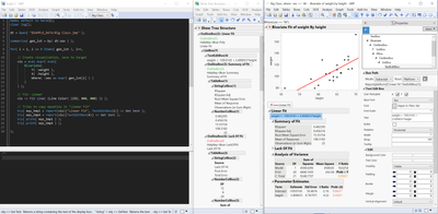

Hello,
Something I've struggled greatly with is how to Get *something* from platforms. In this case, it's the linear fit equation just under "Linear Fit". The Properties and Show Tree Structure menu both show different text exit boxes, so I've tried to grab them both and used Get (which isn't recognized by the platform, or maybe just the object), and Get text. Both do not grab the text I require. Any ideas?
Another issue is that 6 reports are generated, where 2 of them should be, since summarize creates a list of unique values in :sex and that's what how many times the for loop is iterating. The reporting is also filtered for these values.
Names default to here(1);
clear log();
summarize( gen_lst = by( dt:sex ) );
for( i = 1, i <= N Items( gen_lst ), i++,
	// Create visualization, save to target
	vis = eval expr( eval(
		Bivariate(
			Y( :weight ),
			X( :height ),
			Where( :sex == expr( gen_lst[i] ) )
	// Fit: Linear
	vis << Fit Line( {Line Color( {255, 000, 000} )} );
	// Tries to copy equation in "Linear Fit"
	try( eqs_tmp1 = report(vis)["Linear Fit", TextEditBox(1)] << Get text );
	try( eqs_tmp4 = report(vis)[TextEditBox(4)] << Get text );
	try( print( eqs_tmp1 ) );
	try( print( eqs_tmp4 ) );

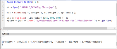

Alternatively, you could use By:
Names Default To Here( 1 );
vis = Bivariate( Y( :weight ), X( :height ), By( :sex ) );
(vis << XPath( "//OutlineBox[text()='Linear Fit']//TextEditBox" )) << get text;
StarfruitBob
Level VI
Re: Get text from reporting platform
Thank you for the quick reply, Hogi!
The alternate code grabs too much text for my liking, as shown in the screenshot.  I'm looking specifically to grab the equation.
However, thank you for catching that I flipped the eval and eval expr! That completely solved the issue! I can use either the first or second try() to get the equations I'm looking for.

hogi
Level XIII
on my system (v17.1):
Hm, I wonder what could make the difference?
hogi
Level XIII
There are less brackets in your screenshot, right?
So, the get text is directly piped to vis and it returns the full report.
