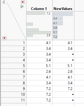

Or you can create new column with values (IfMZ is used to keep first row)
Names Default To Here(1);
dt = New Table("Untitled",
	Add Rows(11),
	Compress File When Saved(1),
	New Column("Column 1",
		Numeric,
		"Continuous",
		Format("Best", 12),
		Set Values([4.1, 3.4, 3.4, 3.4, 5.1, 2.6, 4.1, 3.4, 7.2, 7.2, 7.2])
dt << New Column("NewValues", Numeric, Nominal, << Set Each Value(
	IfMZ(Dif(:Column 1) == 0,
		:Column 1
-Jarmo
