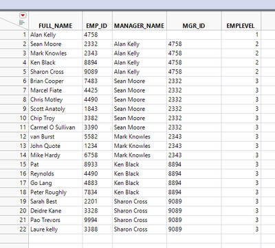

Can someone suggest a method of creating a dynamic nested tree box using Hierarchical Data. I tried for a couple of hours tonight and it is confounding me :(
I have some dummy data below to depict the relationships which is three levels deep. Obviously I don't want to hard code this as I will not know up front how many level of 'nesting' I will need to make. In reality it will be 10 or more levels.
Cheers, Troy
This is what I'm starting with (Table attached)

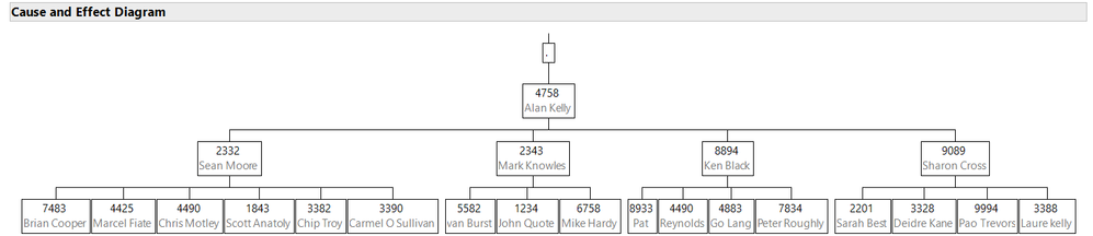

This is what I want to generate

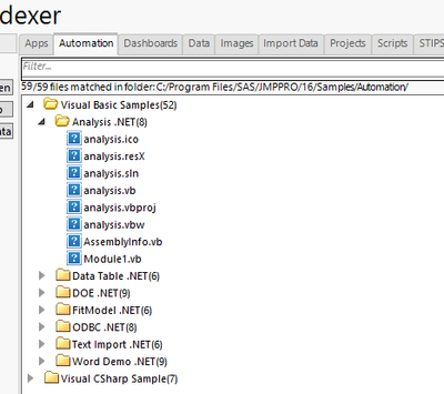

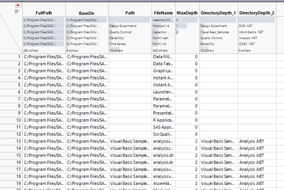

You might get some ideas from here Directory Tree: Explore Space Used by Folders or possibly from file-indexer I have been working on jthi-jmp-tools/file-indexer (github.com) (see bin/bin/DirectoryTreeHandler.jsl, it isn't yet as generic as I would like it to be, but hopefully it will get there), my code is currently a mess, because I haven't had time to finish it and start refactoring.

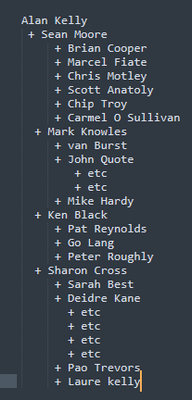

In my code the (current) input is datatable like this:
and current end result something like this:
I modified the input directory list to include one much deeper directory and it seemed to have no issues. I think magic word here might be recursion
Hopefully the function get_directory_roots can give you some ideas.

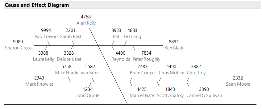

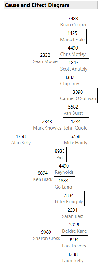

The fishbone diagrams have a right-click menu to rearrange them. They all use the same displaybox tree. It is possible to add other controls to the tree, similar to the label. The platform is hiding under Analyze->QualityAndProcess->Diagram.
dt = Open("/Z:/DummyTable.csv");
diagram = dt << diagram(parent(MGR_ID),child(EMP_ID),label(FULL_NAME));
// fishbone is the default, change it like this:
(report(diagram)[hierbox(1)])<<changetype(
    Fishbone
    //Hierarchy
    //Nested
NestedNested
FishboneFishboneHierarchyHierarchy
edit: it looks like the diagram platform may not be able to reopen a closed node in JMP 15/16 (via popup menu). In JMP 14 it can. I've reported the issue.
