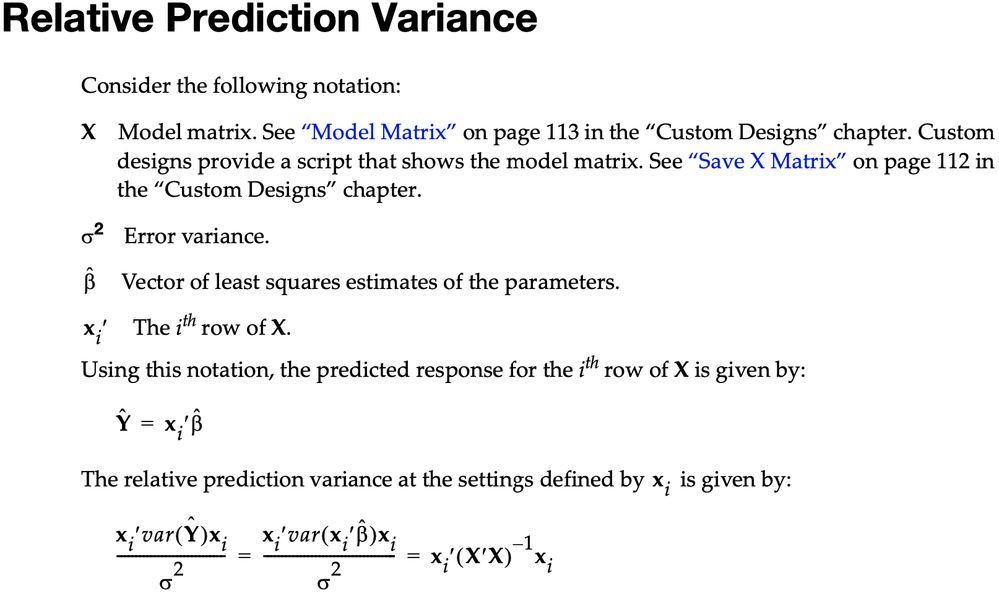

You can use the standard formula for the linear regression if you want to create your own visualization. The formula is provided in the Help > Books > Design of Experiments guide. See the chapter about statistical details. Here is the relevant information:
The result in the lower right is the relative prediction variance, which is the quantity plotted in the Prediction Variance Profiler and the FDS Plot. Multiply this result by the actual response variance to make and absolute result if you like.

Yes you're right Mark, thanks. Indeed my initial idea was to use the Formula Editor to calculate the
expression.
But as I said I am not familiar with Matrix functions in the Formula Editor and I didn't manage to do it...
