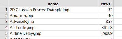

This example uses Files In Directory to get a list of all the files in a directory.  It then looks for all the .jmp files, opens (and later closes) them one by one, making a summary table along the way.  The $sample_data directory has sub-directories which will be in the list but are skipped by the EndsWith test.  EndsWith is case sensitive; you might want EndsWith(LowerCase(filename), ".jmp") to get the files that end in .JMP and .jmp.

summary = New Table( "summary", New Column( "name", character ), New Column( "rows", numeric ) );
For( iFile = 1, iFile <= N Items( fileNames ), iFile++,
  filename = fileNames[iFile];
  If( Ends With( filename, ".jmp" ),
    dt = Open( directory || filename );
    summary << addrows( 1 );
    summary:name = filename;
    summary:rows = N Rows( dt );
    Close( dt, "nosave" );
