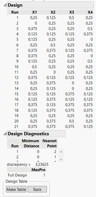

EDIT: I just realized I could use the datatable generated outside of JMP and use it as candidate set in the Space-Filling platform (to enforce the runs through the use of covariate factors), so that JMP can calculate MaxPro and discrepancy values (example here with the external datatable provided in my original post) :
However I'm not sure these values are correct, as I obtain the same MaxPro and discrepancy values no matter which design I load into JMP with this "candidate set" approach (even JMP-generated Space-Filling designs). So this seems like a bug and not actual calculated values. If someone has an idea on how to make the calculations and display them, I would be very happy !

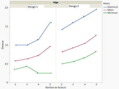

Generating several designs and using distances from Hierarchical Clustering platform already helps assessing the "performance" and points distribution of space-filling designs. Here is a visual comparison of the min, mean and max distance values of 2 designs types with increasing number of factors (dimensionality). The first one see a sharp increase of the distances with increasing dimensionality, whereas the second one seems more "robust" with a linear increase of distance regarding the augmentation of factors. 

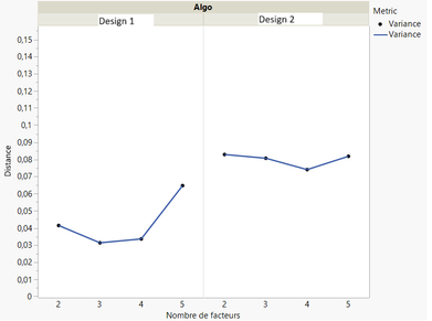

Looking at the Variance of the distances between points (which seems to be correlated with discrepancy values), design 1 seems to have a more compact way to spread points compared to design 2. Design 2 is able to spread points with the same "variability" when increasing dimensionality :
