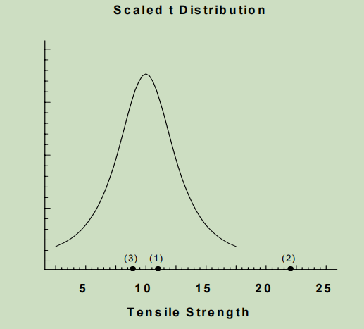

HOW to construct a plot to compare means in JMP
i'm learning Design and analysis of experiment 9th,and in this book introduce some method to compare means by plot,one of the plot is by sampling distribution ,if different group means are in 5%-95% then we can say these treatments dont have effect,and the plot look like this belowScreenshot 2024-08-25 211432.png

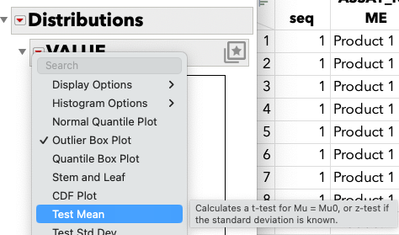

Analyze>Distribution

THANKS FOR YUOR reply,i just try this method you offered,i fpund this method is different from the method mentioned in the book,i did it the way you described and i found out this method compare a group mean to a contsant,but what i really want is comparing different group means in a known MSe after ANOVA

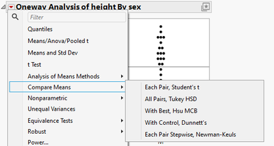

Fit Y by X also has plenty of mean analysis/comparison tools
https://www.jmp.com/support/help/en/18.0/#page/jmp/oneway-analysis.shtml#ww106412
