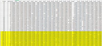

I have a data table that combines 2 datasets for 2 temperature for multiple units. Each unit is subjected to 20+ tests at 2 temps.
I need to generate a delta table for each unit, that calculate the delta between temp2 - temp1 as shown in table "Data_Table".
I keep getting the same error after an incomplete delta table is generated shown next
the error I get
My data table
here is my code, if any can help I would really appreciate it

newRow = dt_delta << Add Rows(1);
Does not return the row number.  If you change it to:
newRow = nrows(dt_delta);
it will work

RayE
Level II
Re: Generate Delta table to calculate deltas between two temp measurments
Thanks Jim, I will the new code, I was getting empty table
RayE
Level II
it worked like a charm!, I will try it on a larger dataset, Thank you Jim
RayE
Level II
confirmed calc in excel as well, data match.
