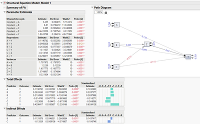

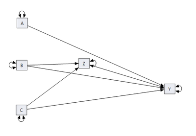

It depends on what your goal is. If you simply want to know the effect of your A, B, and C factors on outcome Y, then leave Z out (assuming you're fitting a general linear model). But if you're interested in quantifying the "mediated effect" that B and C have through Z, then you'd benefit from fitting a structural equation model (SEM) that captures this exact causal structure:
Each node in the SEM represents a variable and each arrow represents a regression effect. Thus, the SEM decomposes the total causal effects of B and C into direct and indirect effects. If this is of interest, then it's worth looking into it. Here's an example with toy data where you can see all the relevant effects in this type of model:

LauraCS
Staff
Re: General Statistics Question on Response Dependence
@statman's reply is spot on. I'd just add the following...
