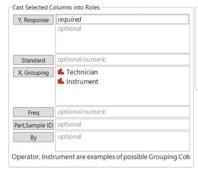

I'm working on a measurement variability study on a product sample. The test is destructive (each test consumes the full sample), so I do not have "true parts" that can be remeasured. My dataset consists of:
1. Multiple technicians
2. Two instruments
3.  2-3 repeated measurements per technician-instrument combination
4. All sample coming from the same material lot
My primary goal is to understand technician-to-technician and instrument-to-instrument variability, I guess I can't do a part-to-part variation. In JMP Gauge R&R platform, I am unsure where all these parameters should go (how do I correctly define "Part/Sample ID" in this case, should I group the analysis by instruments or technician, etc.). From the R&R result, which values should I care about?

Can you make an assumption that some of the parts are identical enough to each other, to consider them the same part?
Few links to check out (not sure if they apply to your situation):
