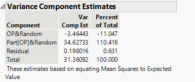

There is no way to "force" EMS within the Variability platform because REML gives better (less biased) estimates when there are negative variance components that need to be zeroed.  However, it is possible to do EMS in the Fit Model platform in JMP.  If you use the following script with the JMP data table you can get the EMS estimates for this random effects model:

Notice that the OP variance component is negative in the Fit Model EMS report.  It just needs to be set to zero to match Minitab.

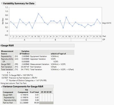

That being said, to be honest, I've never used the JMP Gage R&R (Option under Variability Charts) platform (I'm old school and do the analysis using variability plots, traditional control charts and ANOVA).  The Variance Components (Variance Components option under Variability Charts) appear correct.  The control chart appears correct.
However, when I tried the Gage R&R  option, I got strange and apparently incorrect, results (Perhaps I am doing the analysis wrong??? ). Examining the Variance Components for Gauge R&R, there is no way the Reproducibility is 99.33%.  This appears mis-labeled (I would report this to JMP technical support).
I have attached a journal (and the JMP data table) where I first did the analysis as a nested study (which is incorrect).  Then I repeated the study as a crossed-nested study.  The variance components look correct.  The Gage R&R options look to be wrong?
