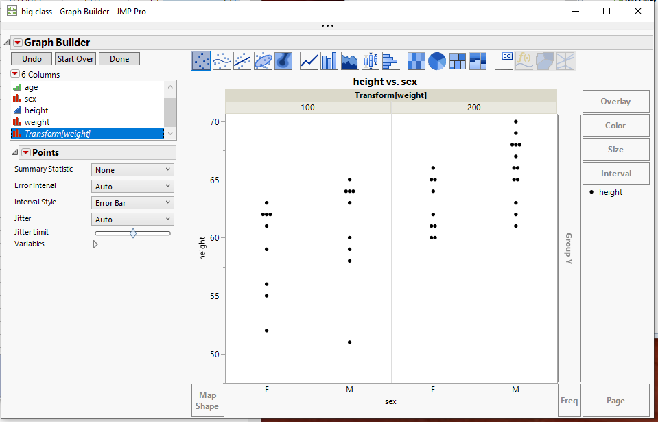

Neither using Value Labels nor a Custom Formula works in changing the the X groupings in Graph Builder, however, you can create a Transform Variable when you run Graph Builder, that you can change the data value and the modeling type to get the affect you want.
Jim

"When a continuous variable is added to a grouping zone, Graph Builder uses quantiles of the data to divide the variable into five groups."
I wanted to know if there is a way to change this "quantile rule" to create intervals with constant bin. If not, I will follow the suggestion of @txnelson and create transformed variables but it can take a while if we need to redo it each time...
