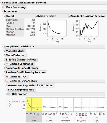

Yes, the Functional Data Explorer should be able to do this, assuming you have a record of the uncontrolled stirring speed. The attached file has a sample script attached that shows an example of using parameters to model the curve (yellow in screenshot below)

I will expand the suggestion by @Jed_Campbell. You have a set of output functions for the process runs and the corresponding stirring speed function for each run. You make a set of functional principal components (fPC) for the online process data curves, save them, and use them as your response in the Y role. You also make a set of functional principal components for the stirring speed functions, save them, and use them as your predictor in the X role. You need to be able to match each Y fPC with its corresponding X fPC for each process run. This arrangement is a matter of using commands in the Table menu. You can use most of the fitting platforms to propose and test models of a relationship between the stirring speed and the process curves.
