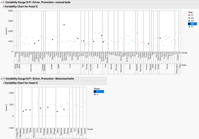

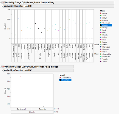

jthi
Re: Changing one color from the legend that is set to JMP Default for multiple graphs in variability chart
Hopefully there are more simpler solutions than this very script heavy one using value colors column property, but this might get you going
Names Default To Here(1);
dt = Open("$SAMPLE_DATA/Cars.jmp");
aa_protection_legend = Associative Array("Year"); // default value Year as I won't write all of these
aa_protection_legend["d airbag"] = "Make";
aa_protection_legend["d&p airbags"] = "Model";
cols_to_color = Associative Array();
cols_to_color["Make"] = "Chrysler";
cols_to_color["Model"] = "Town Car";
vars = dt << Variability Chart(
	SendToByGroup({:"D/P"n == "Driver", :Protection == "d airbag"}),
	Y(:Head IC),
	SendToByGroup({:"D/P"n == "Driver", :Protection == "d airbag"}, Y(:Head IC)),
	SendToByGroup({:"D/P"n == "Driver", :Protection == "d&p airbags"}, Y(:Head IC)),
	SendToByGroup({:"D/P"n == "Driver", :Protection == "manual belts"}, Y(:Head IC)),
	SendToByGroup({:"D/P"n == "Driver", :Protection == "Motorized belts"}, Y(:Head IC)),
	SendToByGroup({:"D/P"n == "Driver", :Protection == "passive belts"}, Y(:Head IC)),
	SendToByGroup({:"D/P"n == "Passenger", :Protection == "d airbag"}, Y(:Head IC)),
	SendToByGroup({:"D/P"n == "Passenger", :Protection == "d&p airbags"}, Y(:Head IC)),
	SendToByGroup({:"D/P"n == "Passenger", :Protection == "manual belts"}, Y(:Head IC)),
	SendToByGroup({:"D/P"n == "Passenger", :Protection == "Motorized belts"}, Y(:Head IC)),
	SendToByGroup({:"D/P"n == "Passenger", :Protection == "passive belts"}, Y(:Head IC)),
	X(:Make, :Model),
	Show Range Bars(0),
	Show Cell Means(0),
	Std Dev Chart(0),
	Points Jittered(1),
	By(:"D/P"n, :Protection)
dt_colors = New Table("colors", New Column("color", Numeric, Ordinal, Values(1::1000)), invisible);
Column(dt_colors, "color") << Set Property("Value Colors", "JMP Default");
colors = Column(dt_colors, "color") << Get Property("Value Colors");
Close(dt_colors, no save);
set_color_property = function({dt, col_name, black_val}, {uniq, color_idx, property_list},
	Summarize(dt, uniq = by(eval(col_name)));
	color_idx = 1;
	property_list = "";
	For Each({val}, uniq,
		If(val == black_val,
			colorval = "\!"" || val || "\!" = 0";
			colorval = "\!"" || val || "\!" = " || char(Arg(colors[color_idx], 2));
			color_idx++;
		property_list = property_list || colorval || ", ";
	property_list = "{" ||Regex(property_list, ", $", "", GLOBALREPLACE) ||"}";
	Eval(EvalExpr(Column(dt, col_name) << Set Property("Value Colors",
		Expr(Parse(property_list))
For Each({{key, val}}, cols_to_color,
	set_color_property(dt, key, val);
For Each({var, idx}, vars,
	rep = Report(var);
	framebox = rep[Frame Box(1)];
	cur_protection = Regex(rep << get title, ".*Protection=(.+)", "\1");
	framebox << Row Legend(
		Eval(aa_protection_legend[cur_protection]),
		Color(1),
		Color Theme(""),
		Marker(0),
		Marker Theme(""),
		Continuous Scale(0),
		Reverse Scale(0),
		Excluded Rows(0)
-Jarmo
	color_idx = 1;
	property_list = "";
			color_idx++;
	rep = Report(var);
		Color(1),
		Color Theme(""),
		Marker(0),
		Marker Theme(""),
		Reverse Scale(0),
		Excluded Rows(0)
-Jarmo
