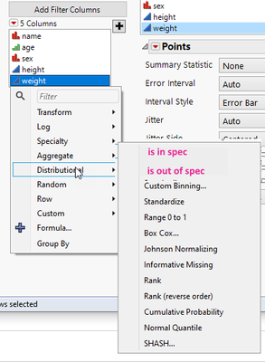

Re: Function to Count Rows Within Spec
Just imagine how useful :folded_hands: is in spec (value)  will be.
With the new functionality any user can do the calculation in Graph Builder !
