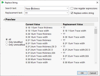

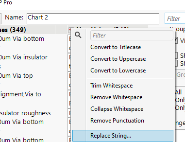

You can use the Replace String in Recode
And in this case it seems to be able to even create working
Local({dt, col1},
	dt = Data Table("Subset");
	dt << Begin Data Update;
	col1 = dt << New Column(dt:Chart);
	col1 << Set Name("Chart 2");
	dt << Move Selected Columns({col1}, after(dt:Chart));
	For Each Row(
		dt,
		col1[] = If(Contains(dt:Chart, "Trace thickness"),
			"TT",
			dt:Chart
	dt << End Data Update;
You can slightly modify it if you wish to

I have further question on Recode, i want recode by chart , filter all the charater when there are "Trace thickness" characters in name, i need recode them to new name "TT"
i have a script but same qustion ,it is not good. Could you also help to check if have better solution for it ? Thanks a lot!   KRs Sean
