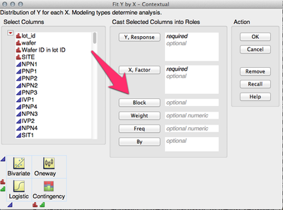

Jeff_Perkinson
Re: Friedman test on JMP?
Hi Jim,
You need to specify your Blocking variable in the Block role in the Fit Y by X dialog:

Hi again!
Thank you. Unfortunately, I havent sorted it out yet. However, perhaps I need to redo the ranks (distribution analyze to save ranks), since when I run the Fit y by x-analyses a post shows up saying "Blocking ignored because cell counts were unequal." After that I excluded a few replicates that contained some empty cells thinking this could be the reason of unequality, saved it as ranks and ran it in fit y by x, but the unequality still remain and the post shows up again). Could it be that there are some species having 6 replicates and, now some are having 5 replicates? All replicates however are equal in number of treated samples (i.e. control and treated). Is this posing a problem for conducting the Friedman test?
In my Fit y by x-runs I used, in the specification model, the trait values as response Y, and the treatment and block number for factor X and block. I even switched the treatment and block number for those two specifications. But in addition to receiving the previously mentioned post sign it did not display any data or relevance (2-way ANOVA p-values for example).
