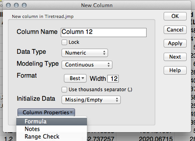

When you create a new column and give it a formula. The formula applies to the entire column and is evaluated for every row in the column.

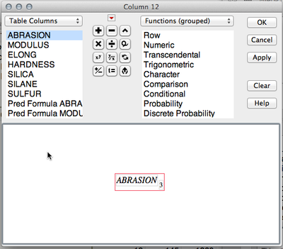

If you want to reference a specific row in a column you can use the Subscript option from the Row functions.
This will give you a subscript for the column you've got selected in the formula. You can put a row number in the subscript and you'll get the value for that column in the row specified.
This formula returns the value for ABRASION in row 3 for every row of this new column.
